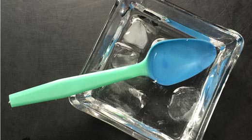

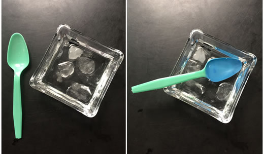

This thermochromatic ice cream spoon changes from green to blue when it gets cold.
