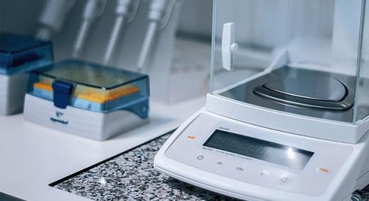

Analytical balance scales are a part of many laboratories. If you use them regularly, you need to keep the analytical scales well-maintained. They are extremely sensitive, and factors like dust, vibration, and air drafts will throw off the accuracy of the scales. This is why it is important to maintain and calibrate them regularly so that you get accurate weights every time you measure.
An analytical balance will work efficiently only if it is maintained properly. Follow the specific manufacturer’s recommendations that come with the balance.
Apart from that, follow these eight tips.
Keep it in the right environment
Keep the analytical balance in an area that is free of vibration and has controlled temperature and humidity.
Don’t place the balances next to doors or windows because opening or closing them will result in air drafts or temperature fluctuations that can lead to inaccurate measurements.
Keep it clean
Keep the analytical balance clean. Debris inside the weighing chamber can affect the weighing results.
