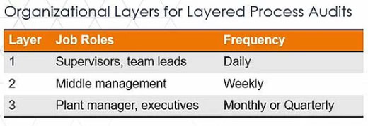

1. Lack of management participation
One common problem with LPAs is low management participation. Plant managers and other layer-three auditors should conduct monthly audits. Quarterly audits simply aren’t enough, and send a clear signal that you don’t have the right commitment to LPAs.
