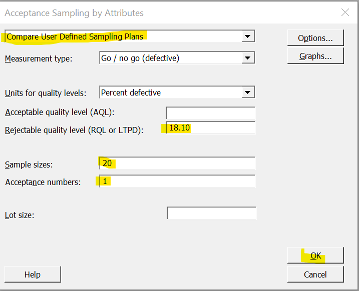

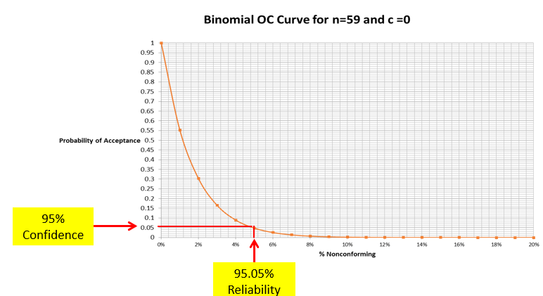

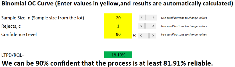

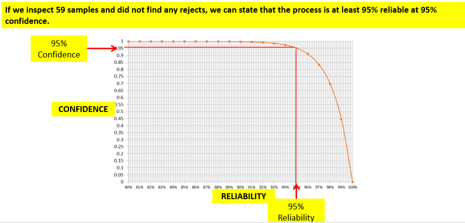

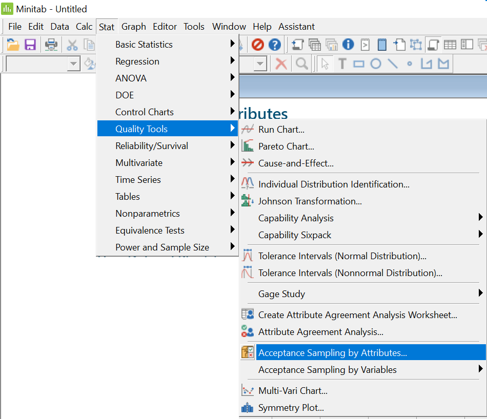

I’m looking at a topic in statistics. I’ve had a lot of feedback on one of my earlier posts on OC curves and how one can use them to generate a reliability/confidence statement based on sample size (n), and rejects (c). I provided an Excel spreadsheet that calculates the reliability/confidence based on sample size and rejects. I’ve been asked how we can use Minitab to generate the same results. So, this post is mostly geared to using OC curves to generate reliability/confidence values and using Minitab to do the same.
