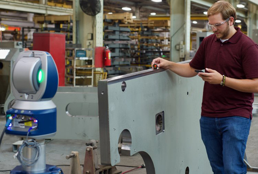

“On our press brake products, we do a measurement between the bed and the ram using a digital indicator,” says Dragoo. “If something was out of tolerance, it was difficult to determine if it was due to the bed being off, the ram being off, or a combination of both. The VantageE provides a better 3D-volume ability to see things. Now we can check the part after it comes off the machining center through assembly and run-in. If there’s a problem, we can see if the problem is in the bed or the ram or both, and by how much.”

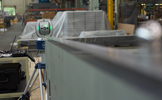

measuring-with-vantage-laser-tracker
Measuring the crown of a press brake ram

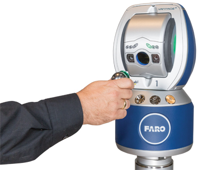

The VantageE supports applications of up to 25 m and has the following features:
• ActiveSeek (patent-pending) technology allows the tracker to find and follow the target, even after the user passes behind obstructions.
• RemoteControls workflow (patent pending) streamlines laser tracker operations, allowing a single user to control functions, such as live video feed and tracker movements, from a mobile phone or tablet. A single operator is able to easily control the tracker from anywhere in the measurement area.
• Industry-leading portability with an integrated master control unit (MCU). These laser trackers are easily transported in a single carrying case between job sites or locations within the factory.
• Hot-swappable batteries eliminate the need for AC power and cabling.
• Industrial-grade Wi Fi for reliable, wireless communications
• Easy integration with FARO’s patented Super 6DoF (degrees of freedom) TrackArm solution to completely eliminate line-of-sight challenges
