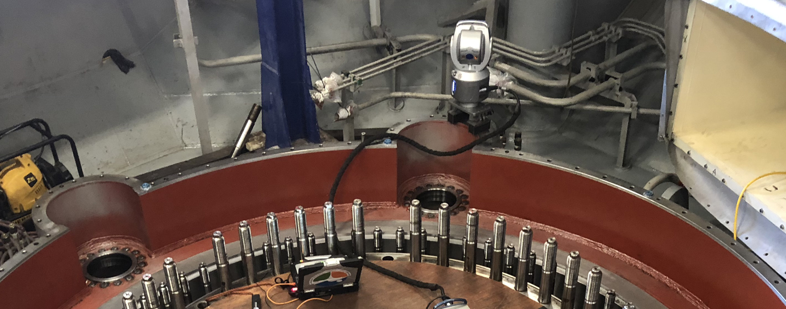

Much of what this successful company does involves outage solutions and in-situ retrofits. In every scenario, accuracy and speed are of the utmost importance. ACQUIP employs laser tracker technology from FARO to help it achieve both. Customers have come to rely on ACQUIP’s ability to deliver outstanding service without sacrificing time or safety.

Today, ACQUIP doesn’t just provide services. A large part of its business is renting specialized metrology equipment for any application. In some cases, the rental clients need to be trained on the use of the equipment they are renting. FARO equipment and software help the ACQUIP team get their clients up to speed quickly.
“Generally, if a client is going to rent a FARO laser tracker, they use FARO CAM2 software,” says Josefsberg. “It's a fairly popular option for people who are renting equipment. We also offer a service called Jumpstart, where we go out and show you how to use the laser tracker for your specific application. As soon as you’re comfortable with it, we leave, and the tracker continues on as a rental. It’s sort of a hybrid rental/training, and CAM2 is fairly simple to teach somebody in a short amount of time.”

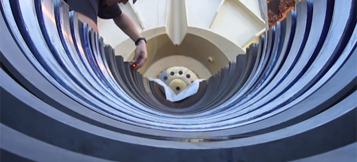

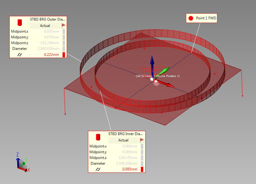

“On a particular job at a shipyard in Spain, the azimuth thrusters were being upgraded, and during the replacement of the drives, the slewing bearings had to be changed out,” says Josefsberg. “We used the Vantage laser tracker to measure the inside and outside diameter of the bearings and map out the casing. We had to ensure that the new bearing was going to fit in the original casing. We were also looking to see if there was any distortion or deformation in the casing or in the bearing.”
The CAM2 software’s simplified analysis and visual reporting allow users to create a coordinate system that is common to multiple elements. Users can quickly scan free-form parts and check their quality in real-time. The software provides immediate feedback with different colors to show deviations from the CAD model during the scanning process. This support easy and prompt identification of inconsistencies.
“We found a problematic area that required machining; the bearing was positioned on a vertical lathe,” explains Josefsberg. “We used the laser tracker to precisely position the lathe’s cutting tool in relation to the bearing. During machining, we would take measurements after each cut to make sure the desired dimension was being achieved. It’s a common practice to use a dial indicator for this kind of work, but we're using the tracker because it’s just more accurate and faster.”
