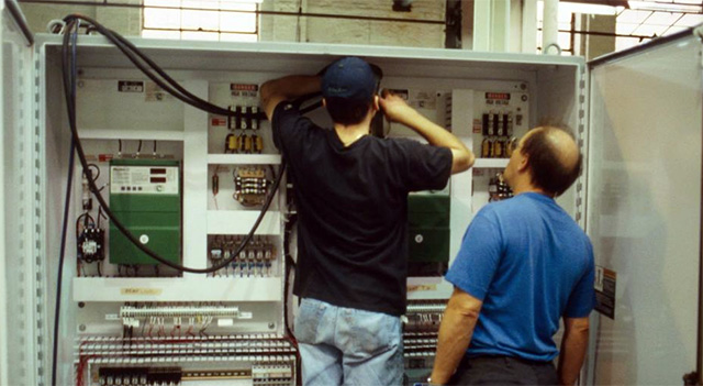

While on-the-job training is practical for certain applications, manufacturers rely on it too heavily as a method for onboarding and training employees.
Companies looking to train a new workforce should be aware that on-the-job training can:
• Hurt productivity
• Increase safety risks
• Impact quality costs
Training without standards
On the surface, the concept of on-the-job (OTJ) training makes sense: Follow an employee around and watch what he does so you know how to do the same. Unfortunately, the desired outcome rarely comes to fruition. OTJ training methods rely too heavily on mentor/mentee relationships and are by their very nature, nonstandardized.
A new recruit may experience a completely different training process depending on:
• Availability of mentors
• Variance in tribal knowledge
• Accuracy of the job demonstration
• Nonstandardized work practices across mentors
