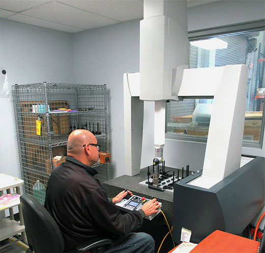

“If you’re measuring very large parts, and you want to do so in an automated fashion, a fixed CMM may be a good solution,” says Mills. “But, when you get into very large volumes, say 2 to 4 m2, the initial investment can run up to a quarter of a million dollars. If it is a very large machine that requires a dedicated foundation, you’re looking at half a million dollars, maybe a million dollars. Large-volume capability has got to be a true value fit to warrant such an investment.”
The size capability of a large-volume fixed CMM also comes with square-footage stipulations.
“Installing a large-volume fixed CMM is a big undertaking,” explains Mills. “Beyond simply acquiring the asset, you often need a dedicated temperature-controlled environment, which means you need the square footage of the CMM’s footprint plus the room it goes in. And you have to consider how you’re going to control the room’s temperature and humidity.”

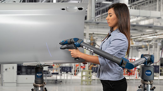

“To reach more than, say, 1.5 m, a fixed CMM typically has to have a long and wide base, and also pushes you up into the real high-dollar CMM price range,” says Baker. “But with something like the 3.5 m (11.5 ft) FARO ScanArm, certified to 0.080 mm (0.003 in.), you can reach to a height of more than 1.5 m (5 ft) from its base.”
“I recently visited a company that used to have three gantry-style CMMs. They sold two of them and now scan everything with a FARO Quantum ScanArm.”
—Les Baker

If your facility needs to inspect dozens or even hundreds of the same part per day, a computer-controlled inspection system with an integrated, fixed CMM may be a cost-effective solution for your needs.
“If you want to do repeat-part inspection in high-volume with cycle times in the five-minute to one-hour range, a fixed CMM is a good way to do that,” says Mills. “It’s an interesting device to consider when you have high-volume, tight-tolerance requirements for a low number of part numbers.”

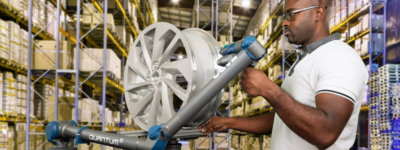

“Where the fixed CMM does fall down a little bit is when you have an application where you do need high accuracy, but you don’t really need the high-volume throughput,” explains Mills. “With the fixed CMM you have to write an inspection routine for each and every part, or you have to manually drive the CMM probe around with a joystick to take measurements. The joy of using a ScanArm is the flexibility; you don’t need a specific, preprogrammed routine to capture those data. With a fixed CMM, it’s not that easy to toggle things on and off, so you end up running the whole inspection routine to get those individual features you may need. Coming from a fixed CMM background, it took me a long time to realize just how flexible a portable CMM really is.”

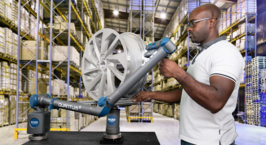

“Out on the shop floor, you’re not talking about a controlled temperature environment,” says Baker. “The fixed CMM room is a temperature-controlled environment, so when you transfer a part into the CMM room to be inspected, you have to wait for it to stabilize before taking the measurements. Then it has to go back out to its machine, be reset up, and then finished. So there’s lots of additional complications and an extra square footage that you have to have available in order to store all those parts while they’re waiting to go on the CMM and transporting back to their machining center.”
“The FARO ScanArm provides a low-cost way of being able to mount the CMM to a machine center and inspect a part actually on-machine without having to break it down.”

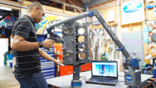

“There are multiple aspects of flexibility, but for me it means being able to measure whatever I want, wherever I want, and the freedom to do so without a predefined inspection routine. I want to capture all the measurement data and evaluate those few points I’m after, and then have the ability to come back and look at data I didn’t even think about on the first go ’round.”
