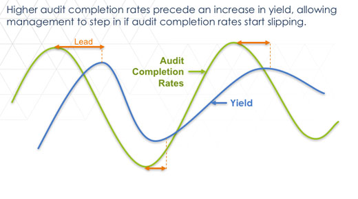

Taking a page from auto manufacturers, aerospace suppliers are increasingly adopting layered process audits (LPAs) as a way to build a competitive edge. LPAs help achieve many quality goals beyond cost and defect reduction, including one that can be hard to pin down: creating a culture of quality.
1. Reducing defects in aerospace manufacturing

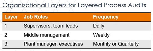

LPAs are a type of process audit conducted daily to standardize processes and reduce variation. What makes them unique is the multiple layers of personnel (including management) conducting the audits. The layers create a high frequency of audits, a best practice when you’re targeting big changes in quality.
