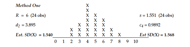

The first method of computing a measure of dispersion is the method taught in introductory classes in statistics. All of the data from the k subgroups of size n are collected into one large histogram of size nk, and a single dispersion statistic is found using all nk values. This dispersion statistic is then used to estimate a dispersion parameter such as the standard deviation for the distribution of X, SD(X).
As shown in Figure 3, the range of all 24 values is 6. The bias correction factor for ranges of 24 values is 3.895. Dividing 6 by 3.895 yields an unbiased estimate of the standard deviation of the distribution of X of 1.540.
The global standard deviation statistic is 1.551. The bias correction factor for this statistic when it’s based on 24 values is 0.9892. Dividing 1.551 by 0.9892 yields an unbiased estimate of the standard deviation of the distribution of X of 1.568.
Figure 3: Method One with Dataset One
Since the original data are given to the nearest whole number, there is no practical difference between the two estimates of SD(X) shown in Figure 3. Whether we use the range statistic or the standard deviation statistic will not substantially affect our analysis.

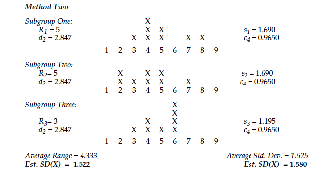

Using Dataset One, we compute a dispersion statistic for each of the three subgroups. Because the subgroups are all the same size, we can average the statistics prior to dividing by the common bias correction factor.
As shown in Figure 5, the subgroup ranges are respectively 5, 5, and 3. The average range is 4.333, and the bias correction factor for ranges of eight data is 2.847. Dividing 4.333 by 2.847, we estimate the standard deviation for the distribution of X to be 1.522.
The subgroup standard deviation statistics are respectively 1.690, 1.690, and 1.195. The average standard deviation statistic is 1.525, and the bias correction factor is 0.9650. Dividing 1.525 by 0.9650, we estimate the standard deviation for the distribution of X to be 1.580.
Figure 5: Method Two with Dataset One
As before, there’s no practical difference between the two estimates shown in Figure 5. Neither is there any practical difference between the estimates in Figure 3 and those in Figure 5. The four estimates obtained using the two different measures of dispersion and the two different methods are all very similar.

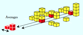

Method Three with Dataset One
The third method will probably seem rather strange. It’s certainly indirect. Instead of working with the individual values as the first two methods do, the third method works with the subgroup averages. These subgroup averages are used to obtain a dispersion statistic, and this dispersion statistic is then used to estimate the standard deviation parameter of the distribution of X.
Figure 6: Method Three for estimating dispersion

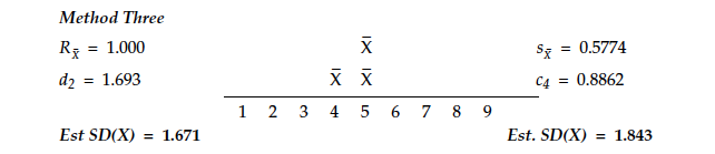

For Dataset One, the subgroup averages are respectively 5.0, 4.0, and 5.0. The range of these three averages is 1.00. The bias correction factor for the range of three values is 1.693. Since each of these averages represents eight original data, we’ll have to multiply by the square root of 8 and divide by the bias correction factor to estimate the standard deviation parameter for the distribution of X. When we do this with the values above, we obtain an estimate of SD(X) of 1.671.
Using the three subgroup averages, we compute a standard deviation statistic of 0.5774. Dividing by the bias correction factor of 0.8862 and multiplying by the square root of 8, we obtain an unbiased estimate of the standard deviation of the distribution of X of 1.843.
Figure 7: Method Three with Dataset One
Once again, there’s no practical difference between using the range and using the standard deviation statistic. Here, the two estimates are slightly larger than before, but not by any appreciable amount.

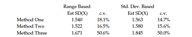

Figure 8: Summary of three methods for Dataset One
As summarized in Figure 8, we’ve just obtained six unbiased estimates for the standard deviation parameter for the distribution of X using three different methods and two different statistics. These six values are listed along with their coefficients of variation (c.v.). The first four unbiased estimates are all quite similar because they all have similar coefficients of variation. The last two unbiased estimates aren’t as cozy as the first four because they have much larger coefficients of variation and therefore have more uncertainty attached.
Before we attempt to draw any lesson from this example, we need to know that Dataset One has a very special property. When we place Dataset One on an average and range chart, we end up with Figure 9. There, we see no evidence of any differences between the three subgroups. Dataset One contains no signals. It’s pure noise.
Figure 9: Average and range chart for Dataset One
Therefore, at this point we can reasonably conclude that when the data are homogeneous and contain no signals, the three methods will yield similar values for unbiased estimates of SD(X) regardless of whether we use the range or the standard deviation statistic.

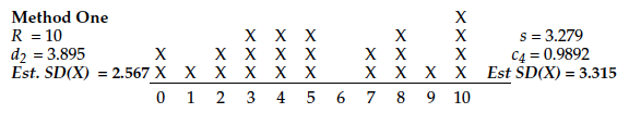

Method One uses all 24 values in Dataset Two to compute global measures of dispersion. As shown in Figure 12, the global range is 10.0, which results in an unbiased estimate of the standard deviation parameter of 2.567. The global standard deviation statistic is 3.279, which gives an unbiased estimate of the standard deviation parameter of 3.315.
Figure 12: Method One with Dataset Two

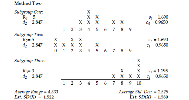

Method Two with Dataset Two
Using Method Two, we compute a dispersion statistic for each of the three subgroups. Because the subgroups are all the same size, we can average the statistics prior to dividing by the common bias correction factor. As shown in Figure 13, the average range is 4.333, and the bias correction factor for ranges of eight data is 2.847. Dividing 4.333 by 2.847, we estimate the standard deviation for the distribution of X to be 1.522.
Figure 13: Method Two with Dataset Two
The Method Two estimates of SD(X) for Dataset Two are exactly the same as those obtained for Dataset One in Figure 5. Thus, the Method Two estimates are not affected by the signals introduced by shifting the subgroup averages.

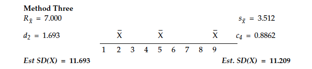

For Dataset Two, the subgroup averages are respectively 5.0, 2.0, and 9.0. The range of these three averages is 7.00. The bias correction factor for the range of three values is 1.693. Since each of these averages represents eight original data, we’ll have to multiply by the square root of 8 and divide by the bias correction factor to estimate the standard deviation parameter for the distribution of X. When we do this with the values above, we obtain an estimate of SD(X) of 11.693.
The standard deviation statistic for the three subgroup averages is 3.512. Dividing by the bias correction factor of 0.8862 and multiplying by the square root of 8, we obtain an unbiased estimate of the standard deviation of the distribution of X of 11.209.
Figure 14: Method Three with Dataset Two
These Method Three estimates of SD(X) are seven times larger than values found in Figure 7. Thus, the signals introduced by shifting the subgroup averages have severely inflated both of the Method Three estimates.

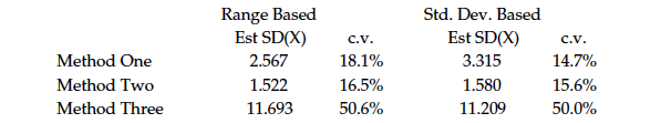

When we summarize the results of the three methods with Dataset Two, we get the table in Figure 15. We’ve obtained six unbiased estimates of SD(X) using three different methods and two different statistics, yet these six values differ by almost an order of magnitude.
Figure 15: Summary of three methods for Dataset Two
The differences left to right in Figure 15 show the effects of using the different dispersion statistics. The differences top to bottom reveal the differences due to using the different methods. Clearly, the differences left to right pale in comparison with those top to bottom. The key to filtering out the noise so we can detect the signals doesn’t depend on whether we use the standard deviation statistic or the range, but rather on which method we employ to compute that dispersion statistic.

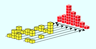

Method One estimates of dispersion are commonly known as the total variation or the overall variation. Method One is used for description. It implicitly assumes that the data are globally homogeneous. When the data aren’t globally homogeneous, this method will be inflated by the signals contained within the data, and the value obtained will no longer estimate SD(X).
Figure 16: Total or overall variation

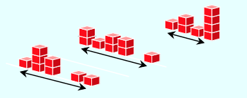

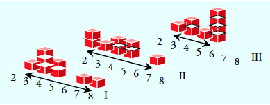

Method Two estimates of dispersion are commonly known as the within-subgroup variation. Method Two is used for analysis. Whenever we seek to filter out the noise to detect signals, we use Method Two to establish the filter. Method Two implicitly assumes that the data are homogeneous within the subgroups, but it places no requirement of homogeneity on the different subgroups. Thus, even when the subgroups differ, Method Two will provide a useful estimate of SD(X).
Figure 17: Within-subgroup variation

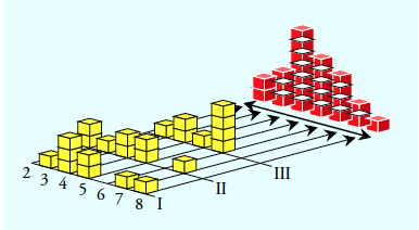

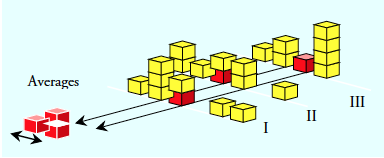

Method Three estimates of dispersion are commonly known as the between-subgroup variation. Method Three is used for comparison purposes. It assumes that the subgroup averages are globally homogeneous. When Method Three is computed, it’s generally compared with Method Two, the idea being that any signals present in the data will affect Method Three more than they affect Method Two. When the subgroups differ, Method Three will not provide an estimate of SD(X).
Figure 18: Between-subgroup variation

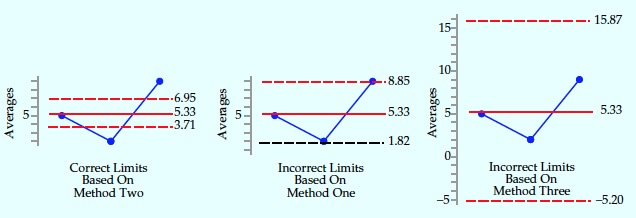

So when it comes to filtering out the noise, you have a choice between Method Two, Method Two, or Method Two. Any method is right as long as it’s Method Two!
Method One is inappropriate for filtering out the noise because it gets inflated by the signals. Method One has always been wrong for analysis, and it will always be wrong. Trying to use Method One for analysis is so wrong that it has a name. It’s known as Quetelet’s Fallacy, and it’s the reason there was so little progress in statistical analysis in the 19th century.
Figure 19: Average charts for Dataset Two
Method Three is completely inappropriate for filtering out the noise because it will be severely inflated in the presence of signals. If you use Method Three to filter out the noise, you’ll have to wait a very long time before you detect a signal. So, while there are analysis techniques that make use of the Method Three (between subgroup) estimate of dispersion, they do so only to compare it with a Method Two (within subgroup) estimate of dispersion.

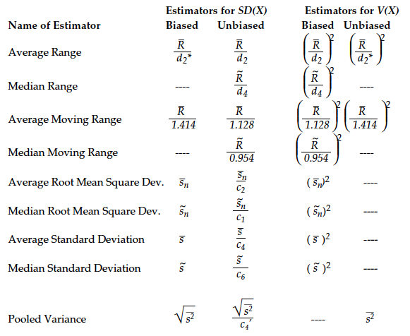

To help with this problem of identifying naive techniques, Figure 20 contains a listing of 27 of the more commonly encountered within-subgroup estimators of both the standard deviation parameter and the variance parameter. There, we see the hallmark of the within-subgroup approach: Each estimator is based on either the average or the median of a collection of k within-subgroup measures of dispersion. Method One and Method Three each use a single measure of dispersion.
Now you know the importance of using the right method, and you know what the right method will look like in practice. Although this may be more than you ever wanted to know about statistics, it’s essential knowledge for all who seek to understand their data.
Figure 20: Some within-subgroup estimators
