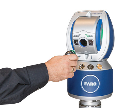

One recent innovation by FARO Technologies Inc., called ActiveSeek, significantly improves usability by less seasoned operators.
ActiveSeek is a patent-pending feature available on FARO’s VantageS and VantageE laser trackers. The ActiveSeek feature enables the Vantage tracker to actively seek and lock onto a target after a beam has been lost during operation. What this means is that when a line-of-site beam is broken because an operator must walk behind an object or climb up scaffolding while taking measurements, the Vantage tracker will seek and lock onto the target again when the target is in a stable position—automatically. The stereo cameras used for this feature afford a 50-degree field of view—the best in the industry—and make ActiveSeek effective across a wide footprint.
“ActiveSeek totally changes the whole mindset of what you’re doing,” says Pfeffer. “Operators can focus more on their work now. That increases productivity, and even for the expert it saves time. ActiveSeek just makes it easier to make sure your tracker is giving you the best data all the time.”

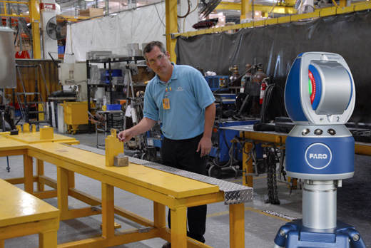

“We had one of our sales associates show this to a customer who was using a competitor’s product,” explains Cassady. “The customer is a major user of a competitor’s laser tracker. They tried out a FARO VantageS with ActiveSeek and compared it to the competitor’s laser tracker in a ‘bake-off.’ They were measuring a large, complicated assembly. With the competitor’s laser tracker, it took seven hours to do the measurements, plus another four hours to create the inspection report with the competitor’s software for a total of 11 hours. Using a Vantage with ActiveSeek, the measurements were completed in five hours, and, using FARO software, the report was generated in just two hours. Total effort with FARO/Vantage was seven hours vs. 11 for the competitor.
“To perform the measurements, the user had to climb on the frame of the large assembly and pass behind many steel plates,” continues Cassidy. “Every time, ActiveSeek with its industry-leading 50-degree field of view was able to find the SMR in just a couple of seconds.”

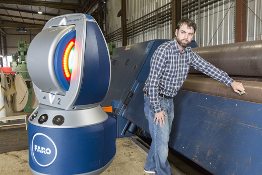

“Laser trackers can give you live measurements and real-time feedback,” says Pfeffer. “So, when you’re doing tool building, or moving details on an assembly fixture into place, aligning rollers or system components, anywhere you need to move something dynamically into place with precision, that’s the place for the tracker. Any machinery that needs to be aligned to run well can be maintained with a tracker.
“Once a company owns a tracker to do a specific job, they always find that they can use it over here and over there, and ‘we have a machine over there that could be aligned,’ and ‘this thing could be inspected’ so, it builds on itself,” notes Pfeffer.
“It can start out leveling the bed that a machine is going on, and then building up the machine piece by piece,” he says. “Trackers have unparalleled ability in replacing parts that must be aligned in applications, like in a power plant or a mill. These applications are becoming more and more common with the ease of use and the price combination of the tracker.”
