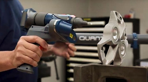

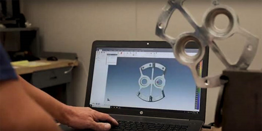

“Using the FAROBlue scanner, I can develop a point cloud and merge that with the CAD model,” explains Corey Phillips, Brodie metrology technician. “With that I can create a sectional view, which gives us an indication where part material might be under- or oversized. We’re now able to give feedback to the operator and use the FaroArm to do confirmation of the parts while they are still on the machine.” In the past, parts had to be removed from the machine for inspection elsewhere in the factory. This consumed transit time, but even more so, it may have taken more time to remount the part in the machine than it took to re-machine the part.

“Before we had the FARO, we needed to inspect prototype castings that were machined outside of our facility,” says Rogers “We received these 10 castings and it took about 10 days to inspect using our existing CMM because there were some very difficult areas to get to inside of the body. It was a very time-consuming effort. Now, Corey can do the same task in about 30 minutes just as accurately and gather infinitely more data at the same time.”
“Before the FaroArm, inspections were completed using a height gauge with an indicator and a block in addition to a CMM. You could say it took a while.”
—Corey Phillips

“The more I use the CAM2 software, the more I realize how much it can do,” explains Phillips. “Our operators are anxious to dig into its GD&T [geometric dimensioning and tolerancing] capabilities.”
Without the need for extensive training or expertise, CAM2 provides a seamless and manageable measurement experience for all users, along with accurate and comprehensive insight into measurement results.
With Cam2, users can quickly and easily accomplish their measurement tasks, and capture actionable business data through the intuitive user interface and image-guided, automated measurement workflows.
“The reports that CAM2 generates are really nice documents,” says Rogers. “The information and images provide great feedback. CAM2’s report format makes the other stuff look like it’s written in DOS language!”
