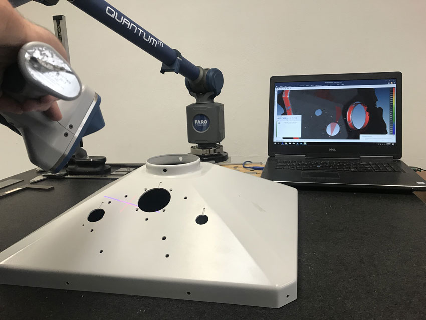

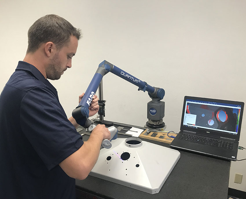

“There’s a lot of unknown features and geometry that you really can’t measure without a 3D scanner,” says Van Tatenhove. “I’ve also worked [around] fixed CMMs, and I’ll tell you, having an inspection tool like the FARO ScanArm right there in the quality room is pretty amazing.”

“I would say going from traditional inspection tools to 3D scanning on complex parts easily cuts your time in half,” says Van Tatenhove. “And the FAROBlu with CAM2 software cuts that time even more because the features are all right in front of you. The X, Y, and Z dimensions are very obvious. You’re not looking at an old display with lines and circles, trying to see where your axis is.”
