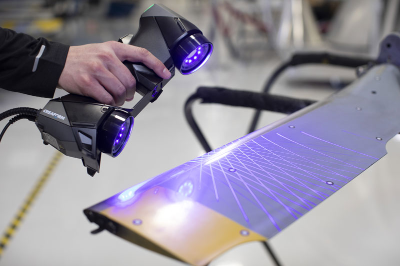

Rather than inspecting all dimensions at the CMM, which requires long programming time and involves qualified resources, the aerospace industry uses a faster and simpler alternative measurement method to inspect less critical dimensions. This alternative method is a metrology-grade 3D scanner called the HandySCAN BLACK, which is produced by Creaform, an ISO/IEC 17025-accredited company.
Metrology-grade 3D scanner
The HandySCAN BLACK excels due to its scan quality, accuracy, and measurement reliability. The HandySCAN BLACK has an accuracy of 25 μm and is in compliance with German standard VDI/VDE 2634 Part 3. Using a safety factor of 5X (i.e., five times more accurate than the smallest tolerance to be measured), the aerospace industry uses the HandySCAN BLACK for inspecting features with tolerances starting at 125 μm (5 × 25 μm) or more.
Speed
With its 11 blue laser crosses, combined with high-resolution cameras and custom optical components, the HandySCAN BLACK can perform up to 1,300,000 measurements per second in addition to generating an automatic and instant mesh. This means that, unlike a cloud file, the generated mesh is already lightened and processed, which reduces the need for data filtering and lessens the variability on data processing. Thus, the aerospace industry retains the same confidence it has in a CMM because the data obtained with the HandySCAN BLACK are consistent and repeatable.
Portability
Because the HandySCAN BLACK is a portable device, it can be moved to any stage of the manufacturing process to perform an intermediate check without having to move parts. For example, it allows a pump to be inspected before machining to ensure that there is enough material, as well as after machining to validate that the dimensions are accurate. The HandySCAN BLACK can also be used to check the dimensions of gears before and after their heat treatment. Only a portable metrology tool enables quality and production teams to perform these intermediate checks quickly and easily during the manufacturing process.
