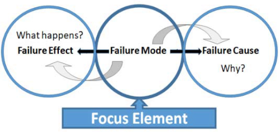

Step 4: Failure analysis
Identify failure modes, effects of failure, and causes of failure.
The failure analysis step described in the AIAG & VDA FMEA Handbook is significantly different from the analysis of failure described in the AIAG FMEA Guidebook, fourth edition. (See figure 1.) The handbook instead promotes the use of a “failure chain” of the failure mode at the focus level, the effect of failure at the next higher level, and the cause of failure at the next lower level.

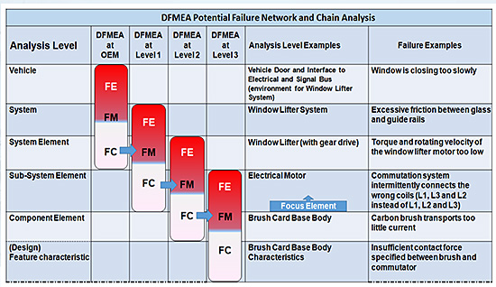

Figure 1: Failure analysis step from the AIAG & VDA FMEA Handbook, first edition, 2019
In the design FMEA, the definition of multiple types of failure modes—e.g., loss of function, degradation of function, intermittency of function, partial functioning, and unintended functionality—is the same for DFMEA in both the handbook and the AIAG Guideline. Failure modes apply to the failure of the focus element product to meet requirements.
Effects of failure are evaluated for impact on the next-higher level of product.
Causes of failure, per the handbook, are typically assigned to the components that make up the focus level of the product. Causes of failure at the focus-element level are only cursorily mentioned.
Given that most design related causes of failure occur at the interfaces between elements, the handbook’s emphasis on failures at the component level, does not appropriately address a very significant issue.
Some dedicated FMEA software systems, notably the Omnex AqUA Pro software, acknowledge the important need to include the analysis of integration and interface failures at the focus-element level. DFMEA improvement should be focused on causes of failure that are within the control of the FMEA team, vs. just assigning causes to the supplier or to a lower-level product.
Additionally, the handbook illustrates the relationship among different levels of product: system, subsystem, components, and feature characteristics, failure effects, failure modes, and failure causes cascade from one product level to the next. (See figure 2 below.)
Figure 2: Relationship among different levels of product, from the AIAG & VDA FMEA Handbook, first edition, 2019
