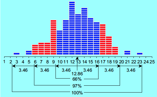

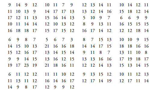

The data in Figure 1 are 200 sequential values obtained over time from a single process. The average is 12.86, and the standard deviation statistic is s = 3.462. The histogram is shown in Figure 2.
Figure 1: Example 1 data
Figure 2: Histogram of the 200 values of Example 1
