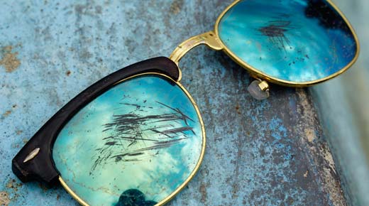

Scratches: Product failure or process failure?
Credit: Stef
