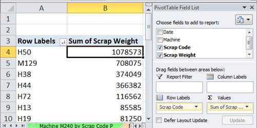

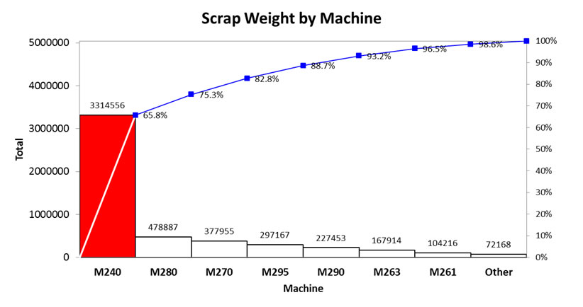

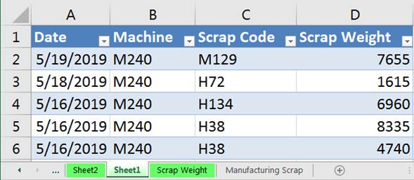

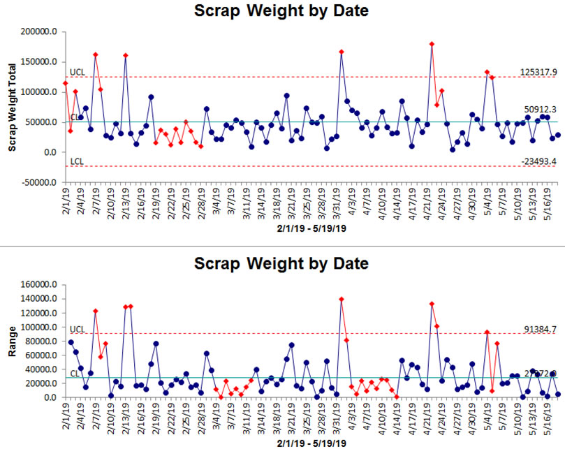

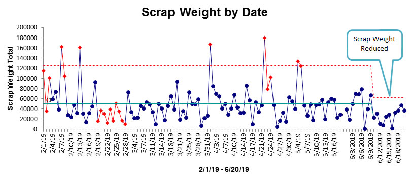

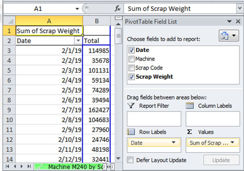

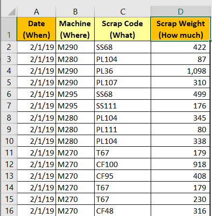

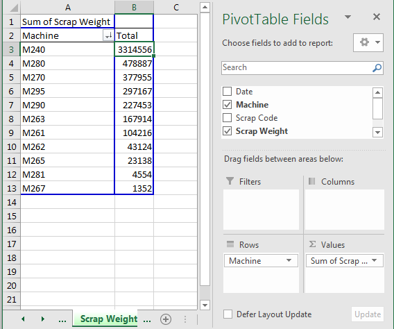

There are two ways to increase profits: increase sales or reduce costs. Although most data analysis seeks to find more ways to sell more stuff to more people, addressing preventable problems is an often overlooked opportunity. Preventable problems consume a third or more of corporate expenses and profits.
Data analysis can pinpoint problems and eliminate them forever. Problem solving with data is a much more reliable and controllable way to cut costs and increase profits. Sadly, few people know how to do this consistently.

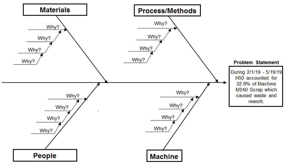

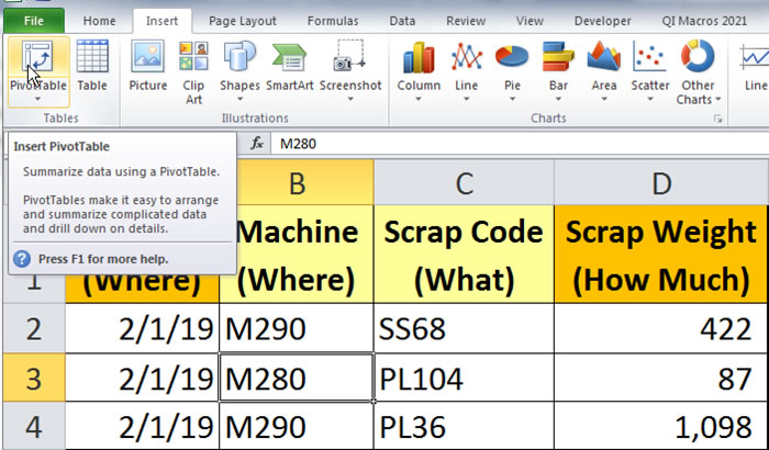

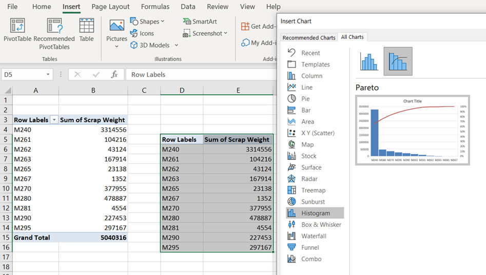

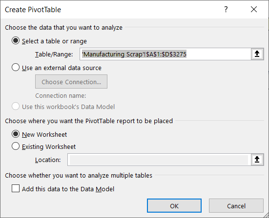

How do you solve operational problems with 100-percent success rate? Take out the guesswork. The vast majority of improvement projects involve reducing or eliminating defects, mistakes, and errors. If you have raw data about when the defect occurred, where it happened, and what type of defect it was, you can create a world-class improvement project that eliminates the guesswork. And you can do it using a tool you most likely already have: Microsoft Excel.
