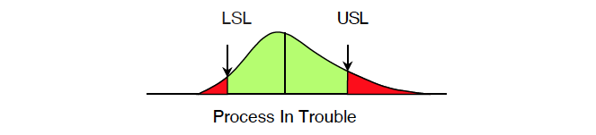

In production, the most common definition of trouble is “too much nonconforming product.” The common picture that comes to mind is that of Figure 1. Here, the process average is satisfactory, but the variation about the average is the problem. With these specifications, you’ll have to reduce the process variation to reduce the amount of nonconforming product.
Figure 1: Traditional concept of trouble
