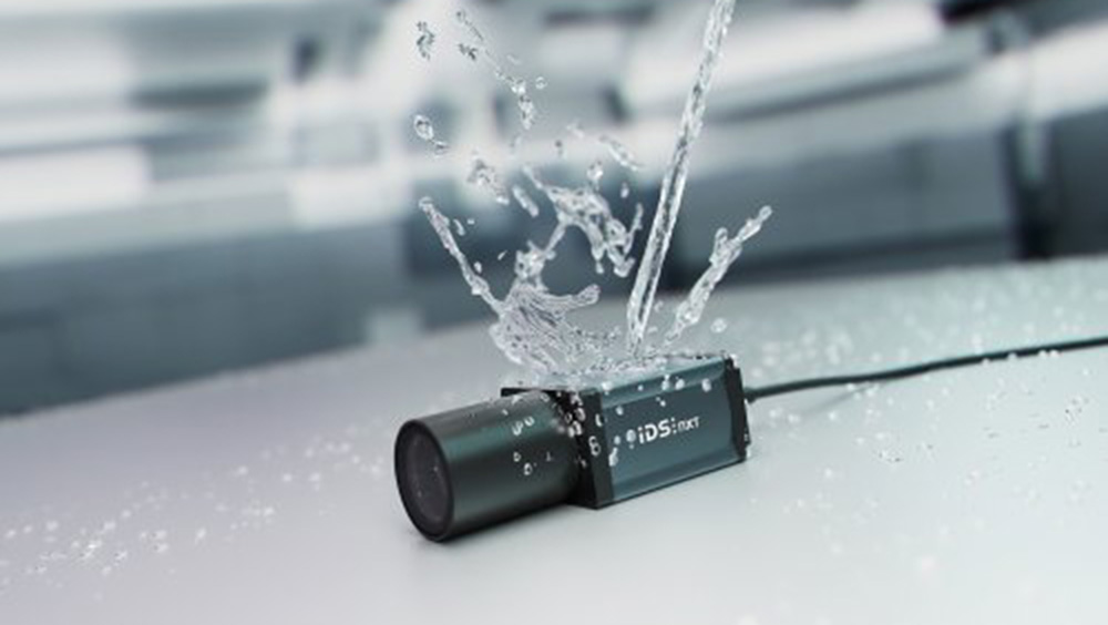

IDS NXT oslo: Video streaming with 5 MP resolution and IP69K ingress protection code.
Wed, 06/04/2025 - 12:01
(IDS NXT: Stoneham, MA) -- With the new IDS NXT oslo, IDS Imaging Development Systems is systematically expanding its range of high-performance AI cameras. The model combines artificial intelligence with first-class image quality, video streaming, and recording functions in a compact, industrial-grade housing—protected to IP69K standard, the highest degree of protection against the ingress of dust and high-pressure water.
The centerpiece of the new camera is a chip from Ambarella, already known from its sister model, the IDS NXT malibu. It enables compressed video streams in full 5 MP sensor resolution (H.264, MJPEG) with more than 25 frames per second. The output takes place directly on the desired end device via RTSP protocol, without the diversions via an additional PC for analysis or visualization. This makes the camera ideal for applications that require live images, including AI-based overlays.
