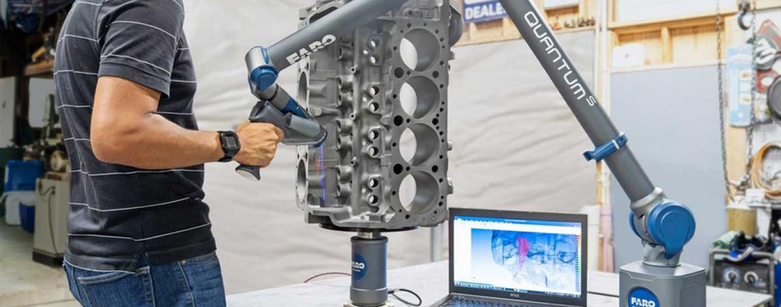

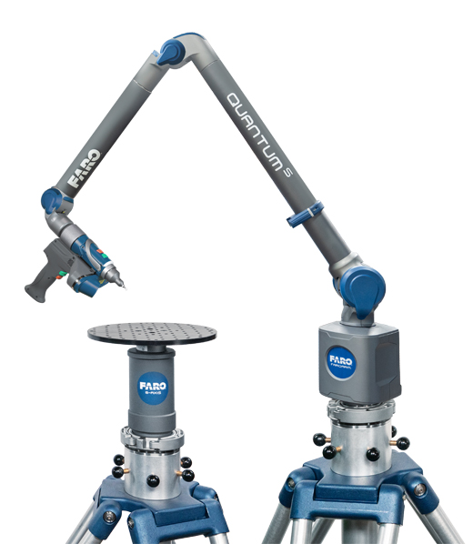

The eighth axis offered by this system is not jointed in the way seen in other articulated-arm portable coordinate measuring machines (PCMMs). Instead, it is a rotary stage that results in a seamlessly integrated, high-accuracy additional axis that requires no additional setup time or effort. In this way, a part can be rotated in real time relative to the arm, eliminating the need to move the arm around the part. This makes it easier to scan and measure hard-to-reach areas, and because the part itself rests on a stable, consistent platform, measurement time as well as human error are dramatically reduced.

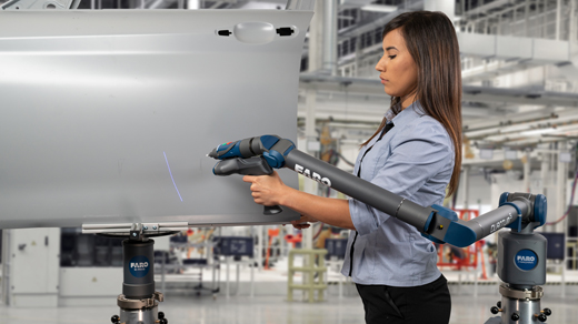

One of the key issues causing slow work flow, reduced accuracy, and ergonomic inefficiency has always been leap-frogging—the practice of having to move an arm around a workpiece, especially within confined spaces.
“We are always looking to improve ergonomics, speed, and ease of use,” says Chuck Pfeffer, FARO’s Director of Product Management and Product Marketing for 3D Factory. “We challenged our engineering team to solve customer problems in scan workflows—reaching over parts, moving the arm, refitting it, and having the scans match. Those are the challenges on the inspection side. At the same time, however, we had product design customers with different workflows and different setups. One of their challenges is that, very often, a design engineer works in a confined space. That engineer might be looking at a part with an arm mounted in a cubicle, where there’s limited room to do a scan by moving the part or moving the arm. With that information, we were able to conceive of an idea to rotate the part, which saves space for the designer and gives a much nicer workflow and ease of use for the inspection customer as well.”

“This whole initiative started from our own 3D Design vertical trying to get measurements done in a confined space,” says Orlando Perez, Chief Platform Owner for the FaroArm and ScanArm. “We had some ideas for creating a scanning station or a smaller arm. All these interesting concepts were being tossed around, and one day we were just sitting there looking at a dismantled arm, when we realized that we had all the components on hand to turn it into a rotary stage. It's all part of the same ecosystem, so to speak—the arm has all these cartridges that calculate the rotations and the movements, and we wondered what would happen if we just added one more, even if wasn’t attached. We then realized that we could use it not only in the 3D Design, but also in the 3D Factory vertical, too.”

• Up to 40 percent time savings when scanning larger parts (examples included a car door and an eight-cylinder engine block)

• Extended measurement volume. The 8-Axis effectively increases the measurement volume by 50 percent by allowing the part to be seamlessly rotated toward where the user is doing the scanning. Some parts that previously required the use of a 4-meter arm can now be scanned with a 2.5-meter arm, which is a major improvement because smaller arms are more accurate than longer ones.

Michelle Edwards, FARO’s Director of Global Applications Engineering and Training, was suitably impressed when she first encountered her company’s new breakthrough product. “When I first saw the 8-Axis, the thing that impressed me the most was the speed it gave and the ease of use. When you think about portable measurement equipment, you recognize how fast it is versus a standard CMM or certainly more legacy hand tools, but with the 8-Axis the speed at which you can capture point cloud data and complete the analysis is very impressive to see. I remember also that I had heard about it, but to really appreciate it I had to see it for myself, maybe because I'm more of a visual person. What impressed me the most was being able to see what I was scanning and rotating at the same time, without having to register together these point clouds or take that extra processing step. The time savings as well as the accuracy stood out, because the 8-Axis allows you to eliminate those steps of putting one point cloud set together with another point cloud set. With this device everything is captured in the same world coordinate system as one complete cloud.

Perez underscores the tool’s accuracy and ease of use. “This device allows you to avoid articulating the arm into all these crazy positions, which increases accuracy,” he says. “You simply stand in front of the part and spin the plate. It couldn’t be any more comfortable or simple to use than that.”
