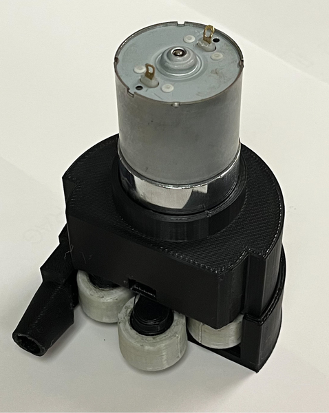

MIT researchers used additive manufacturing to take a major step toward solving this problem. They 3D-printed a miniature version of a type of vacuum pump, known as a peristaltic pump, about the size of a human fist.
This peristaltic pump, about the size of a human fist, performed better than other types of pumps at creating and maintaining dry vacuum—key for enabling a mass spectrometer to effectively determine the molecules in a sample. Image courtesy of the researchers.
