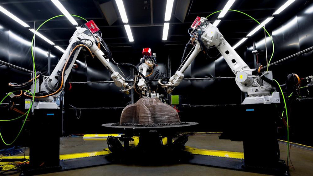

This PM-HIP can was printed on the Oak Ridge National Laboratory’s MedUSA wire-arc additive manufacturing machine. The can will be used to create an impeller for a hydropower impeller to demonstrate a new approach for creating large-scale clean energy components. Credit: Carlos Jones/ORNL, U.S. Department of Energy
