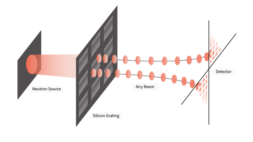

When an ordinary beam of neutrons strikes the team’s silicon grating, the millions of scored lines on the grating convert the neutrons into an Airy beam with a wavefront that travels along a parabolic path. The triangular shapes on the detector match the predicted behavior of an Airy beam, offering evidence of the team’s success.
