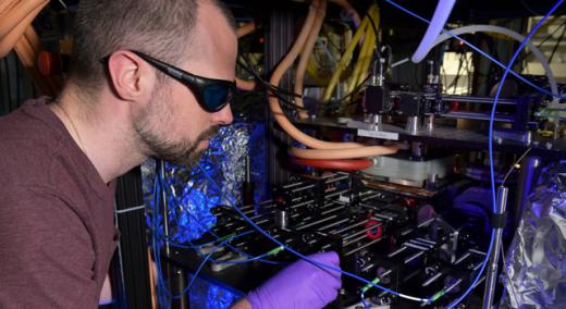

NIST researcher Dan Barker checks on the CAVS setup in the lab. Credit: NIST.
