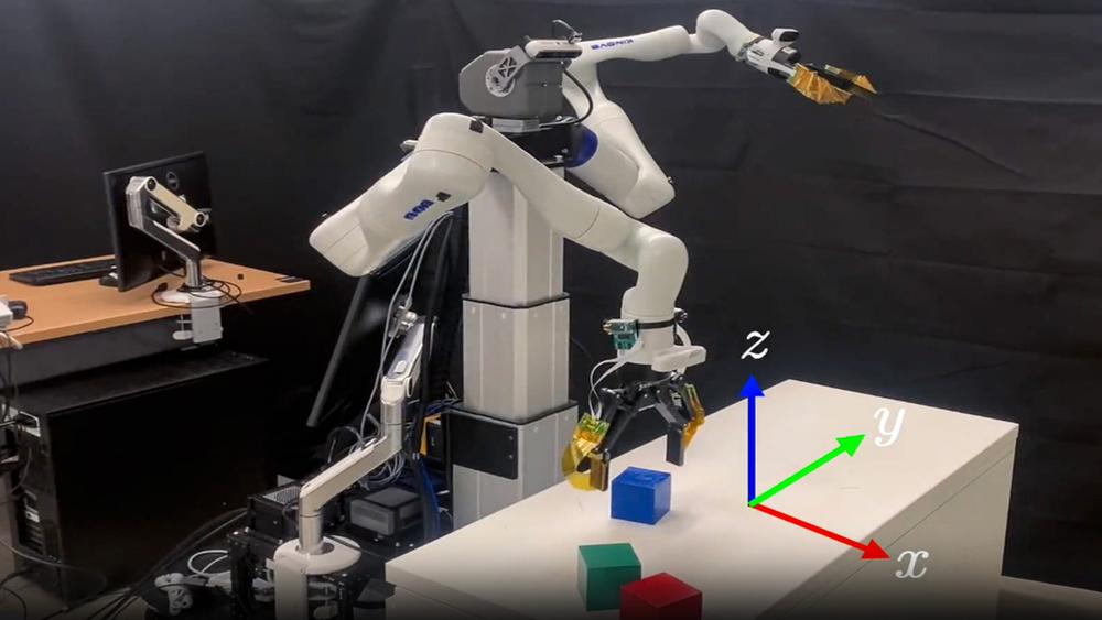

The researchers’ robot planning approach considers thousands of possible actions simultaneously, enabling it to rapidly determine how to manipulate and tightly pack items without damaging them.

Researchers from MIT and NVIDIA Research have developed a novel algorithm that dramatically speeds up the robot’s planning process. Their approach enables a robot to “think ahead” by evaluating thousands of possible solutions in parallel and then refining the best ones to meet the constraints of the robot and its environment.
Instead of testing each potential action one at a time, like many existing approaches, this new method considers thousands of actions simultaneously, solving multistep manipulation problems in a matter of seconds.
