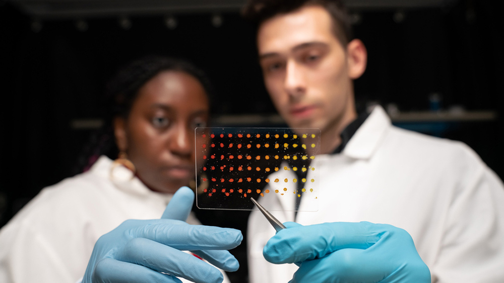

MIT graduate students Eunice Aissi (left) and Alexander Siemenn have developed a technique that automatically analyzes visual features in printed samples (pictured) to quickly determine key properties of new and promising semiconducting materials. Photo: Bryce Vickmark
