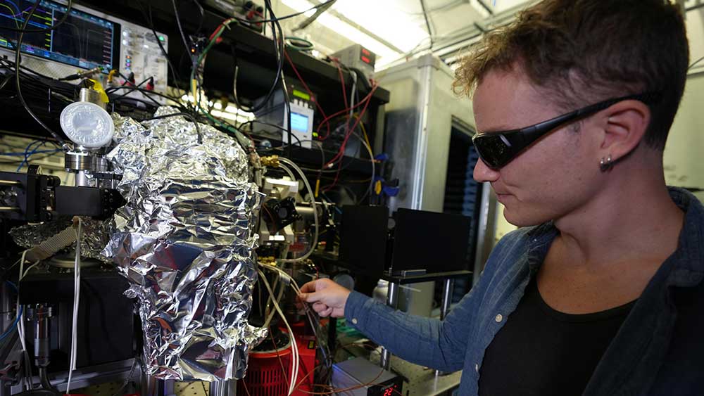

By monitoring how giant Rydberg atoms interact with heat in their environment, Noah Schlossberger and colleagues can measure temperature with remarkable accuracy. Credit: R. Jacobson/NIST
