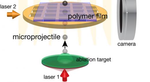

To address this issue, researchers at the National Institute of Standards and Technology (NIST) have designed a method that uses a high-intensity laser to blast microscale projectiles into a small sample at velocities that approach the speed of sound. The system analyzes the energy exchange between the particle and the sample of interest at the micro level, then uses scaling methods to predict the puncture resistance of the material against larger energetic projectiles, such as bullets encountered in real-world situations. This new method, described in the journal ACS Applied Materials & Interfaces, reduces the need to perform a lengthy series of lab experiments with larger projectiles and bigger samples.
