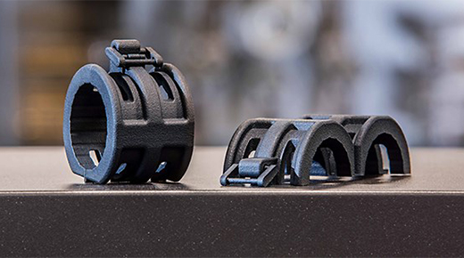

Technology giant HP has developed and launched multi-jet fusion (MJF), an industrial-grade 3D printing technology that quickly and accurately produces functional prototypes and end-use parts for a variety of applications. Protolabs served as one of several test sites for this additive manufacturing process because of its experience in industrial 3D printing, and recently added HP Jet Fusion 3D 4200 printers to its suite of manufacturing tools. Here are several considerations to keep in mind when designing for MJF.
SLS similarities
If you’re familiar with selective laser sintering (SLS) design principles, you’re already close to being an MJF master. Both are powder-bed 3D printing technologies, using a heated chamber, the entirety of which can be used for making parts—there’s no need for supports as there is with other 3D printing processes. Where SLS uses a laser to fuse individual powder layers, MJF uses an infrared heating element together with proprietary fusing and detailing agents.
