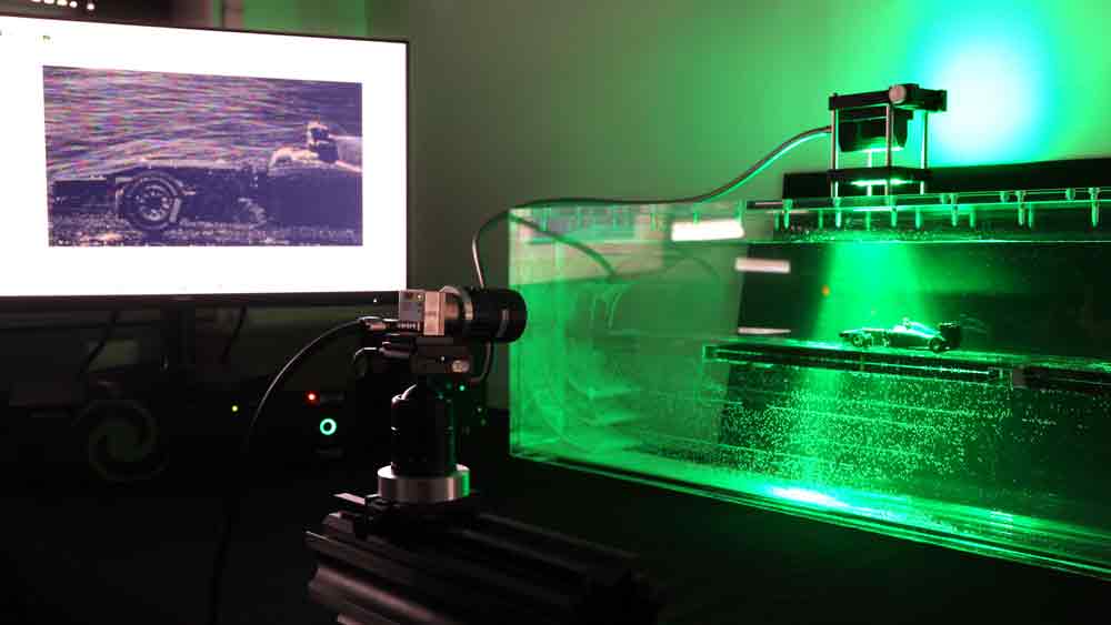

Various methods are available to measure these flows, including visual ones such as particle image velocimetry (PIV). High-resolution cameras are used to track marked particles within a flow and analyze their movement. iLA_5150 GmbH, from Aachen, Germany, also relies on EBIV (event-based particle image velocimetry). It’s a new optical method for the qualitative and quantitative visualization of flows and flow velocities. It combines PIV with event-based cameras, in this case with a uEye EVS from IDS Imaging Development Systems. The innovative sensor technology of this industrial camera enables highly dynamic and energy-efficient detection, especially for fast and turbulent movements.
