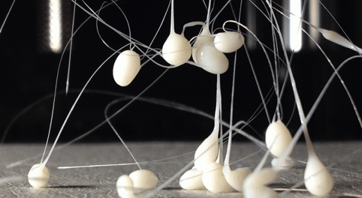

Forgetting support structures
Symptoms: “Why is this print all spaghetti?” “What happened to the underside of the protrusion?” “The print just failed, and I don’t know why.”
