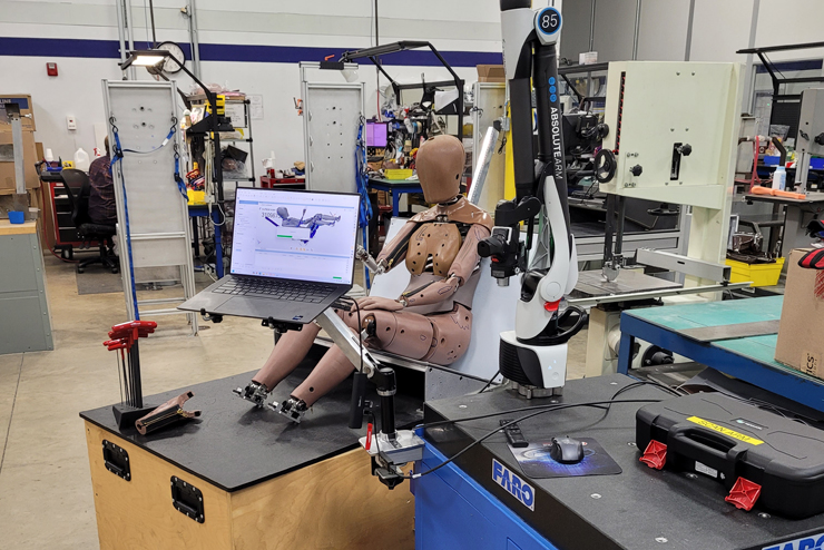

Scanning a pelvis bone using a Hexagon AS1 3D scanner and PolyWorks|Inspector. Image: Humanetics
“Capital equipment decisions at Humanetics, particularly in a period of high growth, are now driven by the question, ‘Does it integrate with our software?’” Unger says. PolyWorks|Inspector runs on Humanetics’ portable arms, CMM, and 3D scanning equipment, making sharing precise data from multiple sources more efficient.
