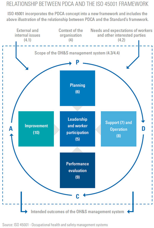

Plan do check act
The plan-do-check-act (PDCA) cycle is outlined in ISO 45001, and will help organizations to continually improve performance because it can be applied to individual processes and to the OH&S management system as a whole:
Plan
• Determine and assess OH&S risks and opportunities, alongside other risks and opportunities
• Establish OH&S objectives and processes that support the organization's OH&S policy
Do
• Implement the relevant OH&S processes as planned
• Eliminate hazards and reduce OH&S risks
• Prepare for and respond to potential emergency situations
Check
• Monitor and measure activities and processes against the OH&S policy and report the results
• Evaluate compliance
• Review the organization's OH&S management system
Act
• Take actions to continually improve the OH&S performance to achieve the intended outcomes
• Report, investigate, and take action to manage incidents and nonconformities
