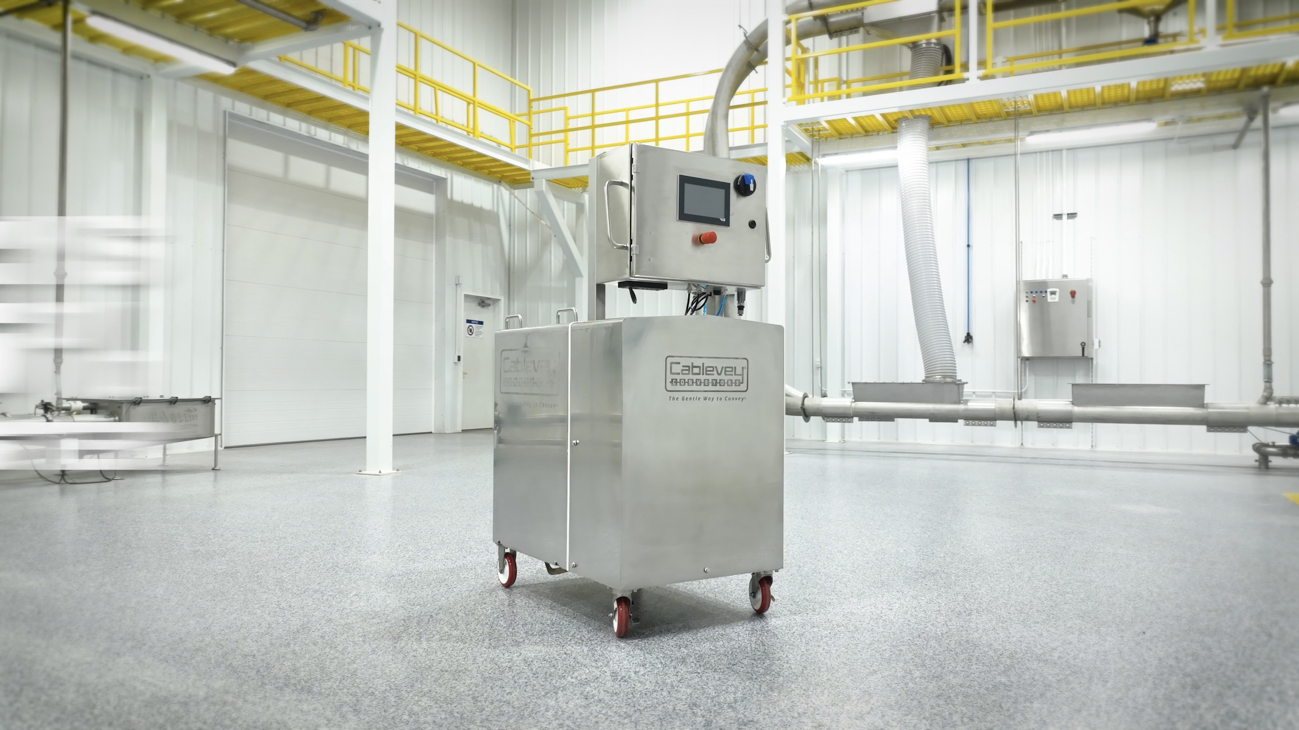

To simplify the wet cleaning process, Adair and his engineering team at Cablevey have developed a small, mobile “smart cart” with integrated water line hookups that a single technician can easily take to any tubular drag conveyor in a facility. When the cart is in position and connected to water lines, the CIP process is automated and controlled by a programmable logic controller (PLC) that reduces the need for manual labor and negates the risk of improper cleaning.
“Once it is set up, all you do is press a button, and it will bring in the required amount of water at the correct temperature with the necessary amount of solvent for cleaning,” says Adair.

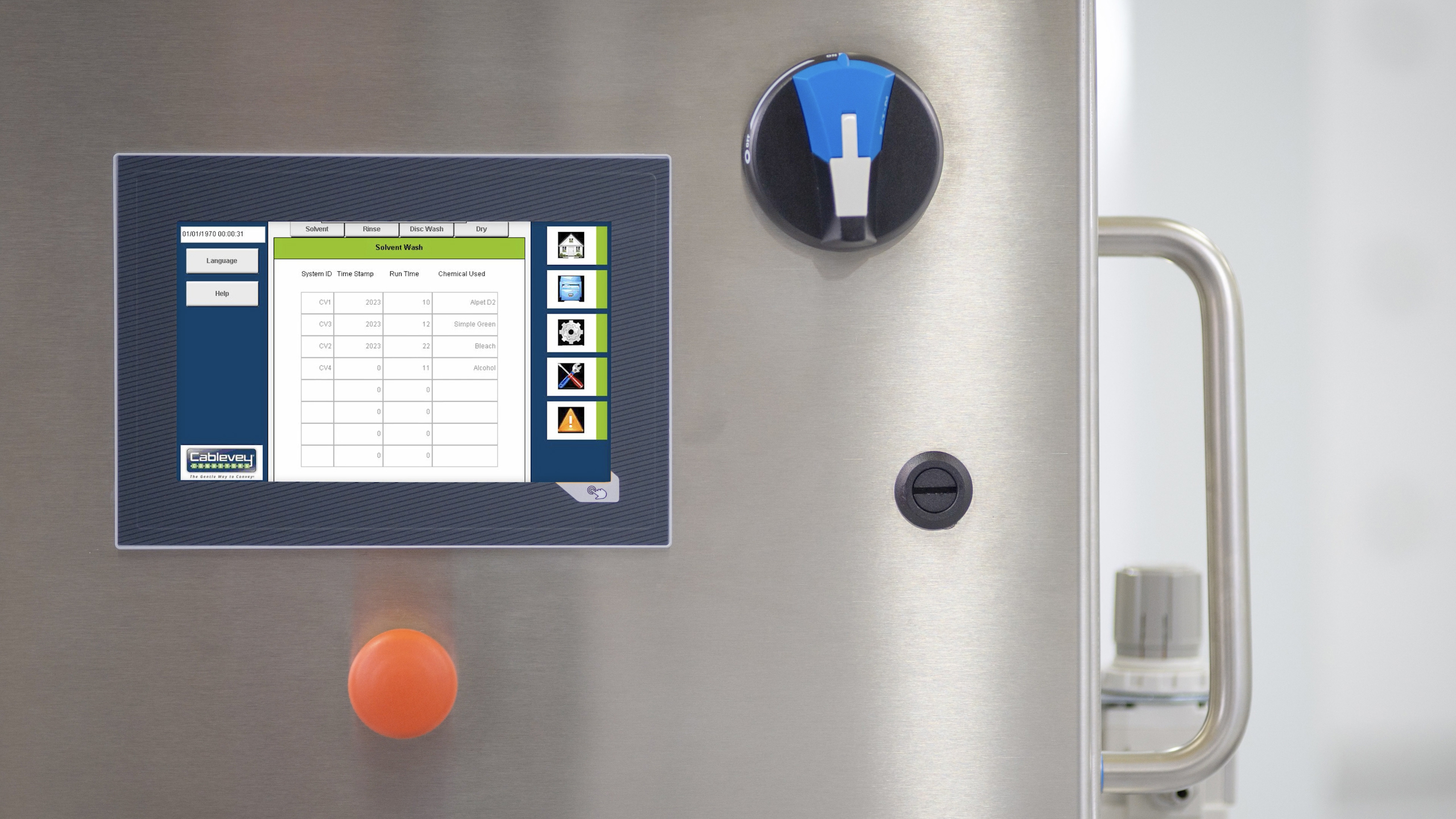

Cablevey’s smart cart stores and uses preprogrammed CIP recipes to flush various residual materials from tubular drag cable conveyors at the push of a button.
The smart cart is designed to store and use preprogrammed CIP recipes to flush various residual materials from the tubular drag cable conveyors in a facility before new production runs. The cleaning recipes enable even those with little training to use the cart. This is helpful in today’s tight labor market and allows the technician to move on to other tasks once the cleaning process begins.
The use of easily executable recipes ensures a superior, repeatable clean that essentially error-proofs the process. This is particularly important when a technician may be new or less familiar with the production equipment.
“[Depending on the product being conveyed], sometimes all you need is a wet rinse, or sometimes you need a specific cleaning solvent,” says Adair. “All that information is saved, so after the first cleaning, it can be automatically repeated. Just push a button to start [the appropriate recipe], whether you have one conveyor running multiple products, or dozens of conveyors running various products.”
To facilitate food safety compliance, the smart cart also documents all critical CIP information, such as water volume and temperature, chemicals used, and cleaning time by date in an easily retrievable data log.

Cablevey’s smart cart is a fraction of the size of similar carts on the market, making it much more mobile.
