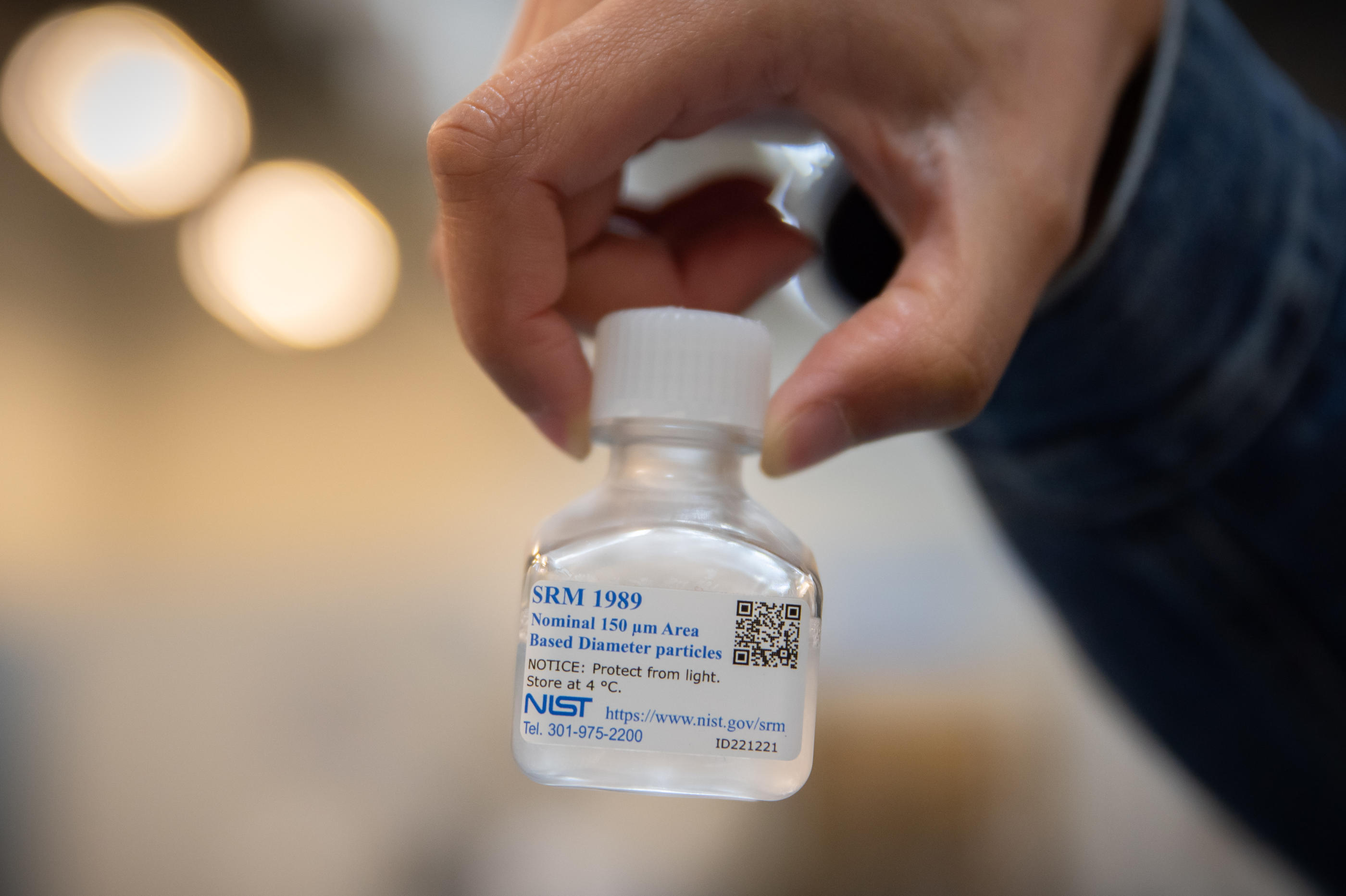

To manage these particles, biopharmaceutical companies need to be able to measure and monitor them. A new standard reference material (SRM) from the National Institute of Standards and Technology (NIST) will help them do that. The new material, SRM 1989: Monodisperse Irregularly Shaped Epoxy-Based Particles, consists of three vials containing particles of different sizes: 220 micrometers, 150 micrometers, and 100 micrometers. (For comparison, a sheet of regular printer paper is roughly 100 micrometers thick.)
