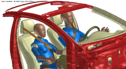

A female passenger and male driver in a driving simulation. (Image courtesy of ESI.)

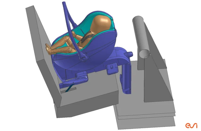

A simulated child in a rear-facing car seat. (Image courtesy of ESI.)
