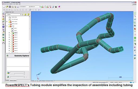

(Delcam: Birmingham, UK) -- Delcam has added two new options for its PowerINSPECT inspection software. PowerINSPECT PartAligner can be used with portable inspection equipment to simplify set-up operations for machine tools. It is similar to the automated position compensation provided by NC-PartLocator for machine tools with probing systems, but uses a separate measuring device. PowerINSPECT Tubing makes it easier to inspect pipework and tubing. Both of the new options will increase the range of applications for PowerINSPECT and so reinforce its position as the world’s leading hardware-independent inspection software.
PowerINSPECT’s Tubing module simplifies the inspection of assemblies including tubing PartAligner
