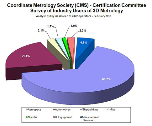

Figure 1: Technology usage by industry sector
To use a technology properly and efficiently you need to understand it. Even a simple measurement tool such as a micrometer needs to be treated with respect and used intelligently. More complex instruments such as CMM arms or laser trackers place higher demands on those who physically use them or make decisions on how best to apply them.

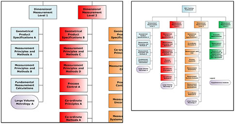

The extended module structure looks like the one in figure 2.
Figure 2: Training module structure

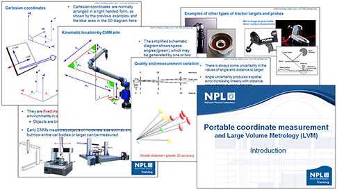

Figure 3: Sample presentation content
The material on day 1 is delivered in PowerPoint format (see sample illustration of content in figure 3) and contains the following elements (with some sample details):
• Introducing portable coordinate measurement and large volume metrology articulated arms: photogrammetric and laser tracking systems are briefly introduced as portable systems and contrasted with three-axis coordinate measuring machines.

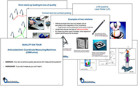

Figure 4: Quality on Tour - sample content
In a related development which underscores the importance of learning about portable coordinate measurement systems, manufacturer FARO Europe has designed its own two-day seminar, “Quality on Tour.” This was originally delivered in Barcelona in 2008 and is currently under comprehensive revision for presentation at various European locations from September 2010. A sample of current revision material is shown in figure 4.
* Engineering and Marine Training Authority, a merger of two previously existing training authorities in the UK.
FARO’s course concentrates on the CMM arm and laser tracker. Although demonstrated using FARO’s own products, the presentations acknowledge the wider spectrum of portable metrology systems, including rival products. FARO not only want users to appreciate the tools of portable metrology but also the quality aspects relevant to good measurement practice.
“Quality on Tour” does not duplicate NPL’s comprehensive training structure or offer formal certification. However, it will certainly contribute to a user’s understanding and help promote quality in portable coordinate metrology for the industry’s general benefit.
