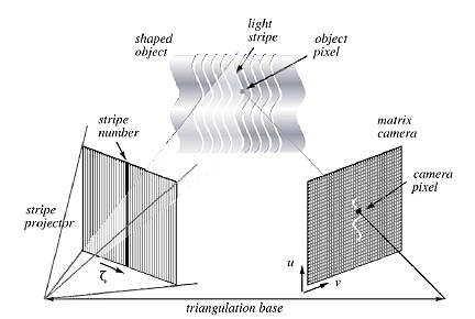

Most area imagers are based on the projection and observation of light onto a surface. Structured light 3-D imagers consist of a projector and receiver covering a slab-like measurement volume. Light is projected onto an area and viewed by a camera (see figure 1). Variations on this include but are not limited to white light projections of various fringes and patterns, laser fringe projection, and laser line sweeping.
Figure 1: This method yields a large number of data points all at once. For example, a system with a 1 megapixel charge-coupled device (CCD) sensor will deliver up to 1 million points per image.

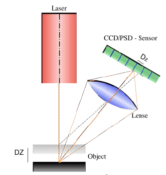

Line scanners use a triangulation method to view a laser line projected onto an object (see figure 2). These systems come in a variety of sizes, with different line lengths, and in some cases with multiple lines and sensors. Some systems use a moving spot instead of a line, but the resulting data is similar in its structure. Laser line scanners collect information on one (or just a few) lines at a time, so they require the use of a 3-D navigation system to position each line as it is measured. As the scanner is moved lines are collected with data rates as high as 10s of thousands of points per second.

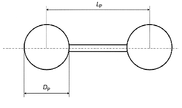

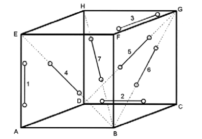

The quality parameter for sphere-spacing tests the system capability for measuring 3-D length. The artifact prescribed is a ball bar with the same ball size as in the probing test and set apart by a length greater than 30 percent of the body diagonal (see figure 3).
Figure 3
The sphere-spacing quality parameter is then tested by measuring the ball bar in seven recommend positions within the systems field of view, with the intent of covering the entire measurement volume (See figure 4). Again, no more than 0.3 percent of the data can be excluded for the sphere fits, but these fits can use known radii. The calculated lengths are then reported as MPE.

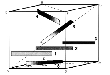

The flatness quality parameter is tested with a rectangular flat with a diffuse surface. The surface may be selected by the manufacturer. The width must be at least 50mm wide and the length greater than 50 percent of the body diagonal. Measurements must be taken in at least six positions (see figure 5), with the results calculated from a best fit plane. Again, only 0.3 percent of the data may be excluded from the fit. The full range of the remaining residuals is then reported as the flatness MPE.
