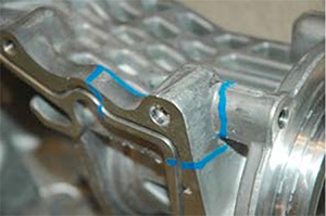

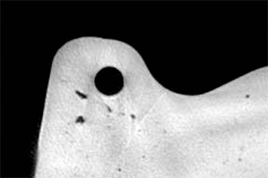

Josh Schradin, one of the 3D Scanning specialists at Exact Metrology’s Cincinnati facility, recently completed a computed tomography (CT) scanning project involving aluminum castings measuring approximately 12 in. x 6 in. x 6 in. and weighing 10 to 15 pounds.
The company’s new metrology-grade GE v|tome|x 300 CT Scanner, with Nanofocus Tube (180kV/15 W) and Microfocus Tube (300kV/500W), is equipped to “look inside” aluminum to a wall thickness or total amount of material of six to seven inches, or a steel-to-wall thickness or total amount of material of one inch.
